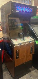

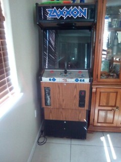

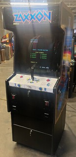

The full-size stand up version uses a really nice metal flight stick with a trigger and an LED on top. The cocktail version uses a standard WICO-style ball joystick.
