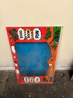

A short upright cabinet with woodgrain sides and front. The monitor bezel has some great artwork with a WWI battle scene on the bottom showing cannons, men, air explosions, etc... On the left side of the monitor are the words 'Action', 'Thrills', 'Fun' and on the right side are the words 'Bang', 'Boom', 'Pow'. Both sets of words are inside either cloud shapes or explosion shapes. All over the bezel are pictures of Biplanes engaged in dogfights. The marquee bezel has the game name in the center with two Biplanes, one on each side. Most of the monitor bezel and marquee are in red. The marquee is originally lit with a long incandecent lightbulb called a 'Lumaline' bulb that glows very nicely, however a bit warm. The control panel has silkscreened graphics which demostrate the controls function and game instructions.
