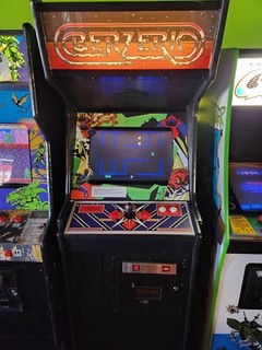

Humanoid player runs through maze-like rooms, destroying robots while avoiding their fire. The indestructable Evil Otto is the game's timer, forcing the player to move on. One of the first talking games, remember "Get the Humanoid!"?
Berzerk was produced by Stern Electronics in 1980.

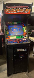

Cabinet Information
The upright cabinet features a patented "board drawer" that allows the boards to be serviced from the front of the machine. Both the upright and cocktail cabinets feature fantastic artwork on the back glass using Marvel comics-style graphics. The look of terror on the humanoid's face (lower left side of the back glass) can often resemble the person playing the game.

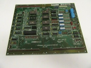

Berzerk can be converted to Frenzy by replacing the ZPU-1000 with the ZPU-1001. Both games use the same power supply, video boards, sound boards, wiring harness, cabinet, and control panel.

Berzerk was originally designed for the 6809E CPU, until it was discovered that the processor did not work properly. The board was then redone to run on a Z80. The speech was done using LPC coding, which cost $1,000 per word to compress at that time. The game also originally had a monochrome monitor, but when Defender was released in color, the company re-considered their display approach and re-designed the display using a color overlay board.
