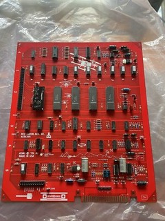

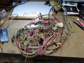

Except for the controller inputs, the wiring harness is nearly pin-for-pin compatible with Battlezone. Red Baron requires just two additional wires: Aux. PCB pin W to Vec/Gen PCB pin W -22VDC and Vec/Gen PCB pin L to Vec/Gen PCB pin P Ties X-invert to GND. It is possible to power up a Red Baron board in a Battlezone and vice versa, but playing the game is nearly impossible without proper controls.
There are several differences in the boardsets, particularly the auxiliary board. Converting a Battlezone vector-generator board for use with Red Baron, is accomplished by lifting pin 18 of IC H1 ROM 037587-01 and pin 13 of IC M2 74LS139N. Connect a wire between the two. Next, swap out the Battlezone ROM's for Red Baron and you are set.
Converting a Battlezone auxiliary board for use with Red Baron is a different matter since the two boards are quite different. The first thing you will notice is that the Red Baron auxiliary board is nearly two inches longer than the Battlezone. Simplified, the Red Baron auxiliary board is more or less populated with one extra column and one extra row of IC's whereas the Battlezone auxiliary board leaves many of the IC pads blank.
