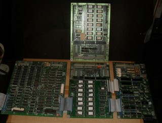

Other games that run on nearly identical hardware are Zoo Keeper, The Electric Yo-Yo, Space Dungeon and Kram. Those games use the same boardset as this game but have the addition of a coin processor board to prevent ROM swaps. A ROM hack exists to make those games run without the coin processor board, so there is a possibility that a conversion could be a straight ROM swap, except for Zoo Keeper which has an additional daughterboard to accommodate more ROMs.

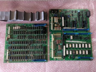

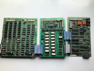

The sound PCB uses a TMS5200 speech synthesis IC. The main processor is a 68A09E.
Fixes
If the original NiCad battery is still on the PCB, remove it and replace it with a 3.6v rechargable, mounted away the board. The 4116 video RAM ICs often fail and since they are becoming hard to find, they can be replaced with modified 4164's.
